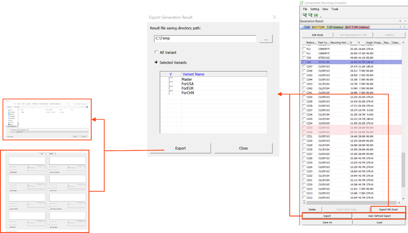

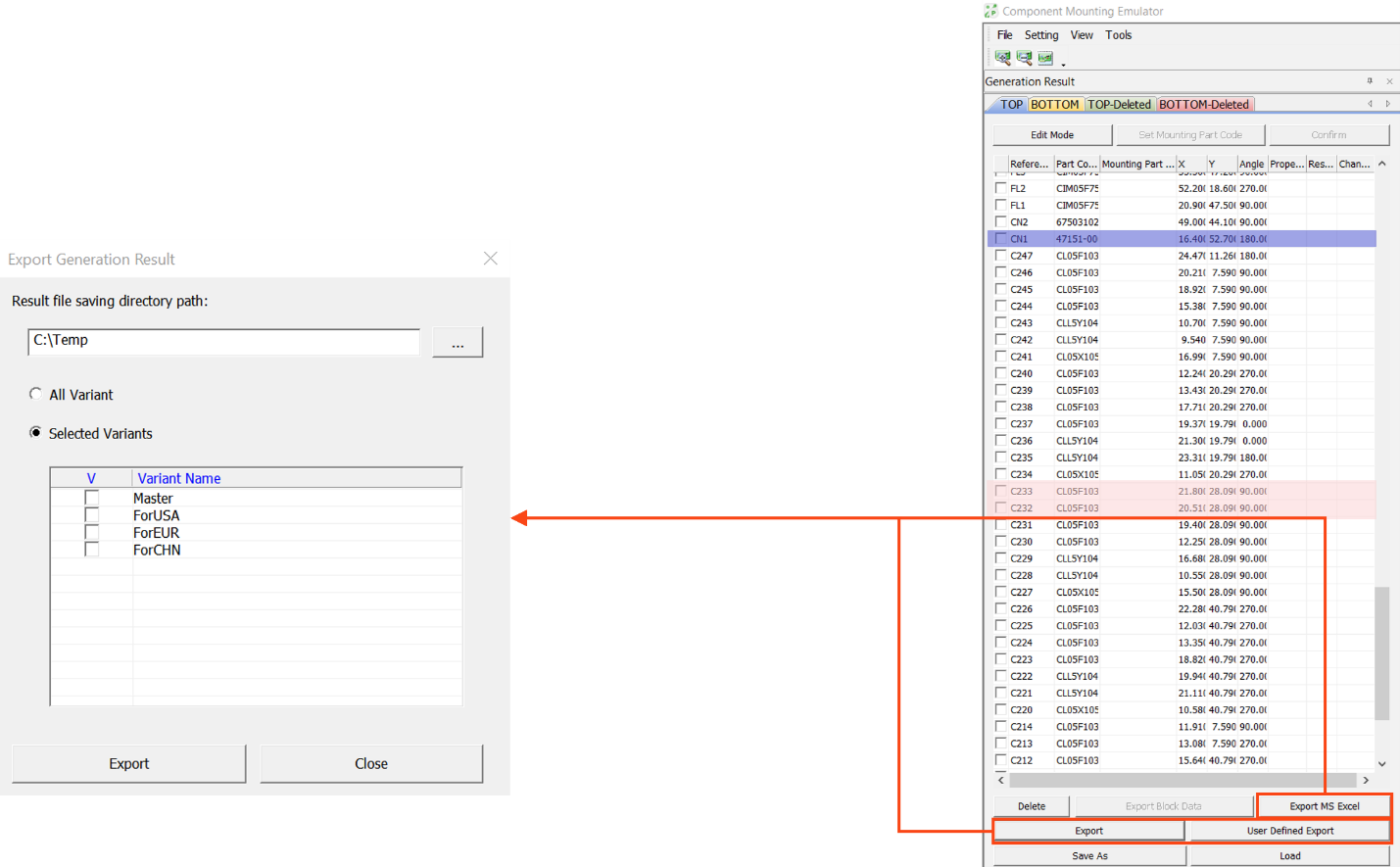

Save and Export
- Delete: Can delete the selected part.
- Export Block Data: Exports the mounting coordinate data of the sub board designated as a block as a text (*.txt) file.
- Export MS Excel: Can export the generated result to Excel file through Direct Generation menu.
- Export: Mount data of the mounter format selected on the Direct Generation Setting screen can be exported.
- User Defined Export: Exports mount data in user defined
format.

- OK: Saves the user-defined format Mount Data as a text (*.txt) file.
- Board Size: Sets the information of board size.
Click Save As to save the created part coordinate data (*.MEMD) file. Click Load to load the saved coordinate data (*.MEMD) file.

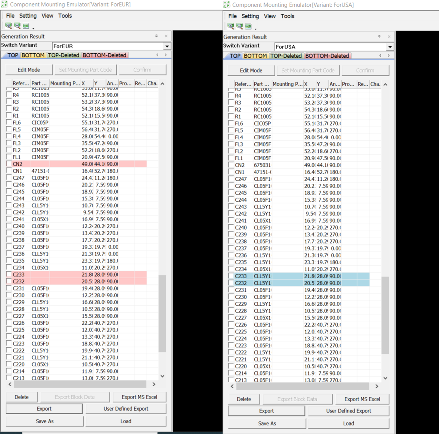

Switch Variant
From Generation result table, you can view the variant list by selecting the variant from the SWITCH VARIANT selection box.
For variant with an NP status the components name in the reference list is highlighted “Red”.
Export MS Excel: Can export the coordinate data for all Variants to Excel file.
Export: Mount data of the mounter format selected on the Direct Generation Setting screens for all Variants can be exported.
User Defined Export: Exports mount coordinate data for all Variants in user defined format.
