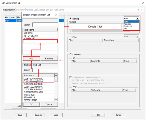

Classify components using the component name. Name matching components are added into the component database.

Create or edit the database file. Once DB files are created, you can update the database for new components.
Classify the component using special characters. Upon searching certain characters in the component name, matched name components will be added into certain component databases.
Classify components with components’ properties (attributes).
The DB file is constructed with ASCII text string.
