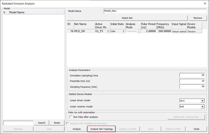

When you select Select Net button, the Analyze Net Topology is activated as below.
the dialog will display. Then if you choose the object you want to analyze using the

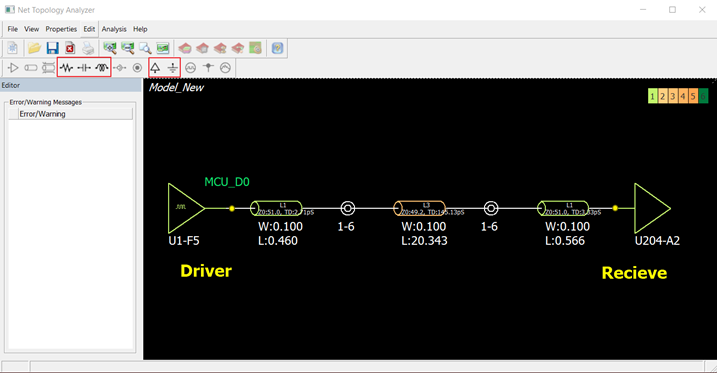

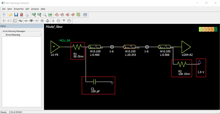

Users can select only 5 different types of components (highlighted in red in the manual bar section) and add these components to both the Driver and Receiver sides.
If you add components between the transmission line or via models, it may affect the simulation results with a faulty. So add the components at the yellow dot pointed in the figure.

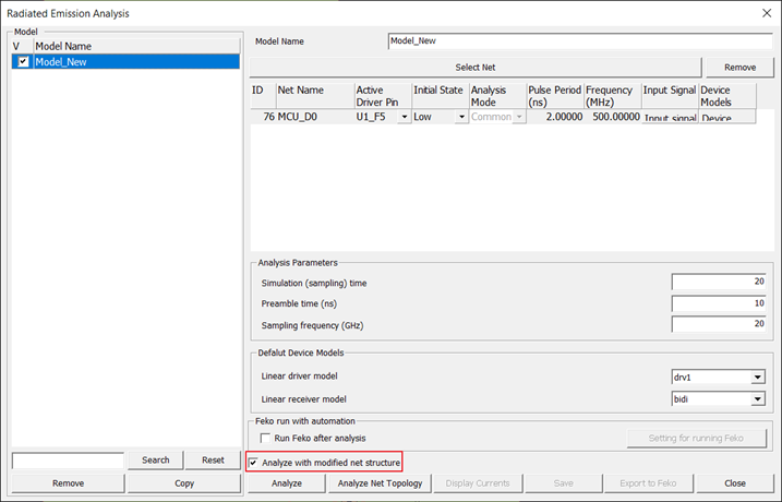

In the Radiated Emission Analysis dialog, the Analyze with modified net structure checkbox becomes active (marked in red box). This allows you to perform radiated emission analysis with the modified net topology. You can write a suitable name in the Model Name section for saving and managing the model.

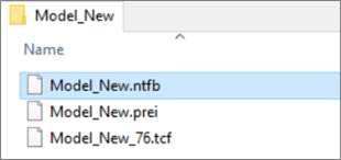

After the simulation, click Save button in the Radiated Emission Analysis dialog box. This stores the modified net topology file (*.ntfb) in the Radiation folder within the *.pdbb directory where the user has modeled.
