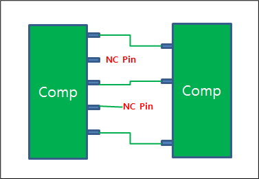

Component pins that are not connected to any signal are treated as NC pins. If any routed traces are connected to these NC pins, they may become good antennas. To prevent this problem, the designer should compulsory connect those NC pins to ground.

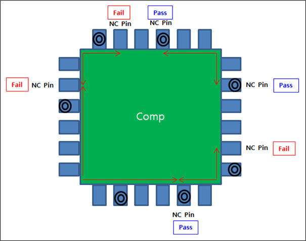

- Via on PAD near Conner: DFE checks if via exists on the first encountered NC
pin pad from each corner side of IC. If the first encountered NC pin pad
does not have via on pad, it reports as failed.

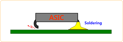

- NC (No Connection) pin
- An NC pin is not connected internally.
- However, if it is connected, for example, to a signal wire, internal noise will increase.
- It is therefore recommended not to connect the pin to anything, or to connect the pin directly to the power supply or ground.
- NC pins may, as an exception, be connected internally. Therefore, be aware of this when NC pins are connected to the power supply or ground.
