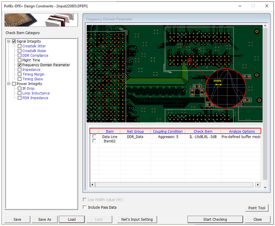

- Item: Sub item name. User can enter arbitrary.
- Net Group: Select target net groups to be tested. Allow multiple net groups.
- Coupling Condition:
- Max number of adjacent signal layers to couple
- Max number of adjacent traces to couple
- Min parallel length for coupling (mm)
- Max via coupling distance (mm)
- Max trace coupling distance (mm)
- Check Item:
- Insertion Loss Limit(dB): If Insertion Loss value is smaller than the limit value user entered, it fails.
- Return Path(dB): If Return Path value is bigger than the limit value user entered, it fails.
- Near-end Crosstalk Limit(dB): If NEXT value is smaller than the limit value user entered, it fails.
- Far-end Crosstalk Limit(dB): If FEXT value is smaller than the limit value user entered, it fails.

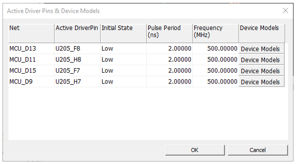

- Active Driver Pins & Device Models: It allows you to select
active driver pins of the coupled nets. To make a net quiet, NONE
must be selected for the active driver pin selection. You can define
the input signal and make changes on the device model selection for
driver and receiver pins of each coupled net by clicking Input
Signal and Device Models, respectively.
Figure 2. - Default Device Models: When the device models are not available in the part data, the default device models defined here are used for transient simulation of signal integrity analyses. With the use of Linear Device Modeler, you can create linear output (driver) and input (receiver) device models and store them in a linear device model file. PollEx DFE+ provides a system default linear device model file, UDVS.dmf.
