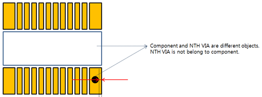

- NTH Via and Overlapping Pad’s Size Checking: If SMD components pad and
non-through holes are overlapped, gap between hole and pad should be
reserved.
Figure 1.- Target Component Group: Select the target component group from the list.
- Minimum Gap between Via hole and Pad: Set the minimum distance value between component pad and NTH Via.
