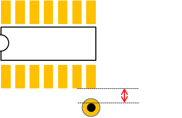

- Checking
- HOLEs on Pad: Check holes are placed on component’s pad.
- Clearance between Hole and Component Pads: Set the clearance
value between target vias’ holes and components.

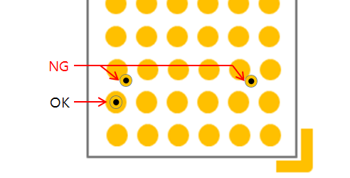

- Via Location on Pad’s Center: If via placed on pad’s area, they
should be placed at same location. Item checks whether they are at
same location or not. If their locations are different, it is
fail.
