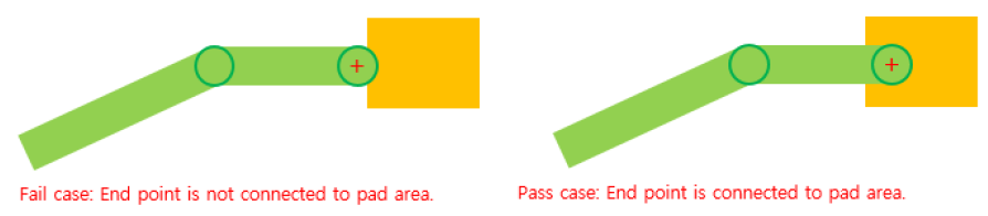

- Detect the end point of pattern which is not connected to pin area:
If the end point of a pattern is not located in the pin area, it
will be detected.

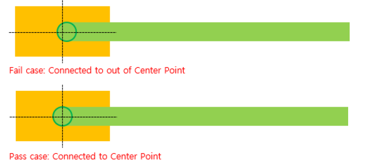

- Center Point Missed
- Pin: Can check the contact of pattern to see if it is connected to
pin center point or not. It can give allowable tolerance to check.
- Example-Pin Case
- Example-Pin Case

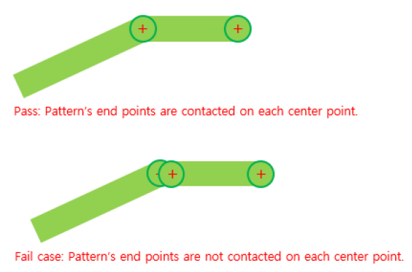

- Pattern: If the center point of each pattern should be contacted, it
can be checked here.
- Example-Pattern Case
Figure 3.
