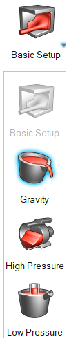

Location: Gravity is an option on the Basic Setup icon on the Casting ribbon.

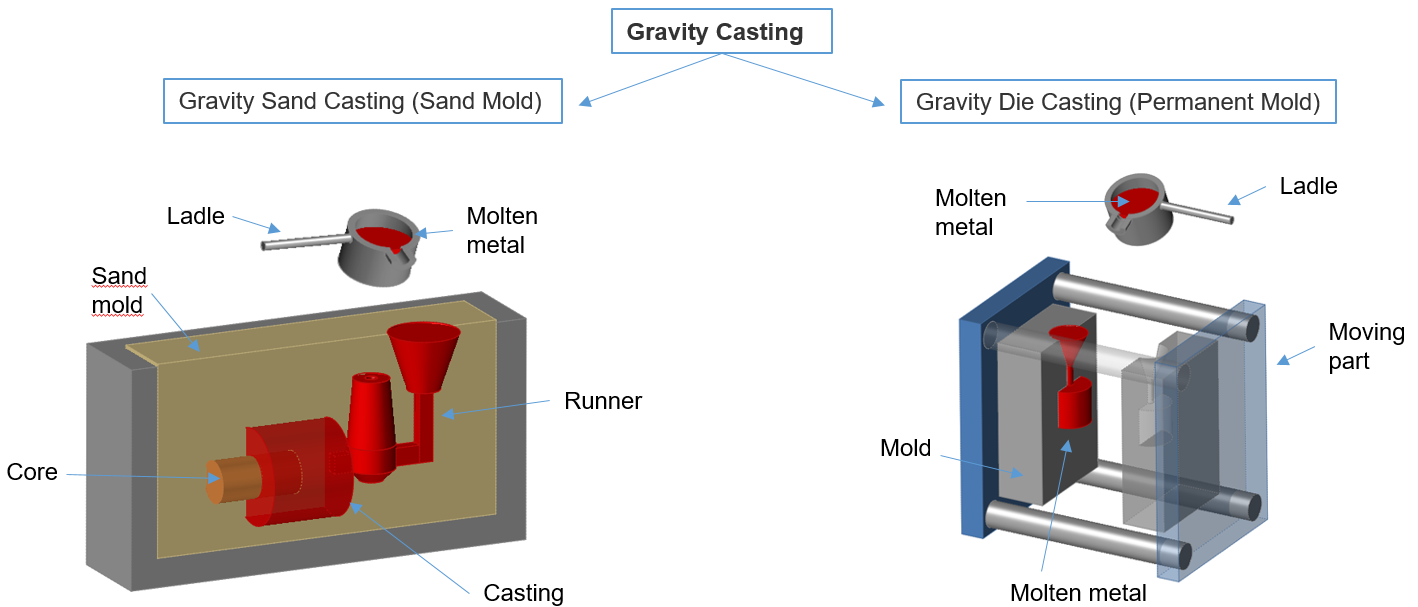

Gravity sand casting has few limits on size, shape, and weight, with low pattern and material costs. However, it is generally less accurate than die casting and has a low production rate due to the destruction of the molds. Gravity sand casting generally uses ferrous metals such as stainless steel, carbon steel, and cast iron.
Gravity die casting is a type of permanent mold casting generally used for the production of small, simple metal parts such as gears, pistons, and wheels. It is similar to gravity sand casting but with a permanent mold, making it a better choice for high production volumes. Gravity die casting generally uses non-ferrous metals such as aluminum, magnesium, and copper alloys, although iron and steel parts can also be cast using graphite die molds.

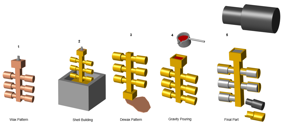

- The wax pattern is created manually or by injecting wax in a mold.
- The ceramic mold (investment) is created by coating the wax pattern by dipping it into sand.
- The shell mold is dewaxed by heating the pattern.
- The molten metal is pored into the hollow mold.
- The shell mold is knocked out to get the final cast part.

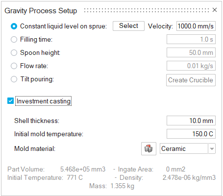

Define Gravity Parameters
Gravity Options

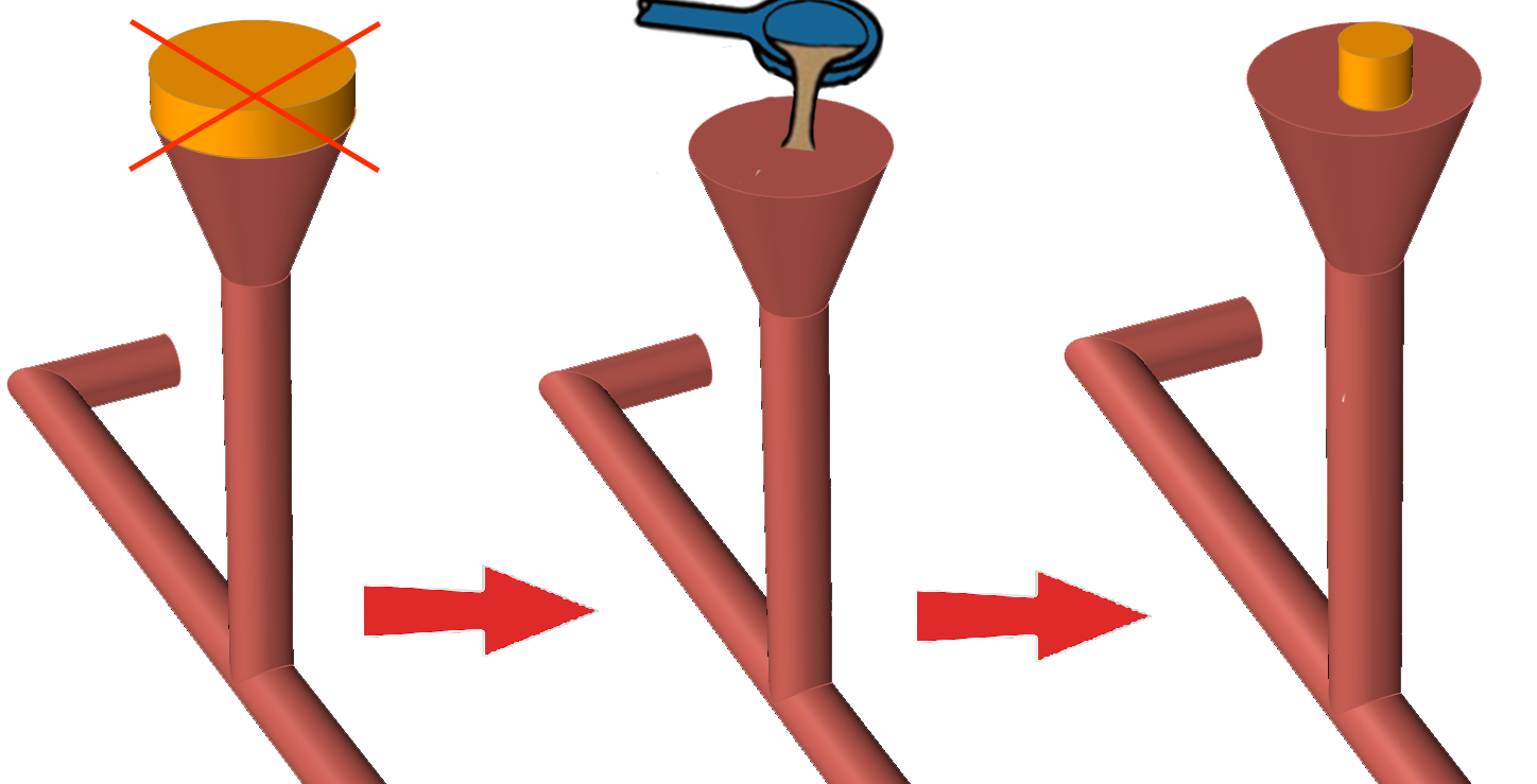

- Constant Liquid Level on Sprue
- Select this option to maintain a constant liquid level on the sprue during filling. Click Select, then click the point on the sprue where the liquid level should remain constant. The flow rate will change during the filling by adjusting the inlet area to keep the selected level constant.
- Velocity
- Use this field to specify the initial velocity of the poured material, or use the default. When the liquid level reaches the specified point, the velocity will adjust to keep the level constant.
- Filling Time (s)
- Select this option if you have calculated the exact filling time
required for your process. Inspire Cast
internally converts the filling time to velocity.
- Spoon Height (mm)
- Select this option when you have totally manual ladle operators. Spoon
height is the distance between the ladle and the mold when the liquid is
being poured. If you don’t know this value, use a value around 10–30 mm.
Inspire Cast internally calculates the
velocity based on the spoon height.
- Flow Rate (Kg/s)
- The flow rate is the poured metal volume in Kg divided by the filling
time in seconds. This parameter can be calculated when using an
auto-pour ladle, bottom-pour ladle, stop-and-rod ladle, etc.

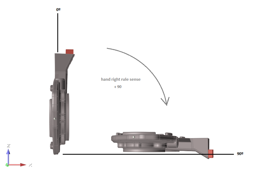

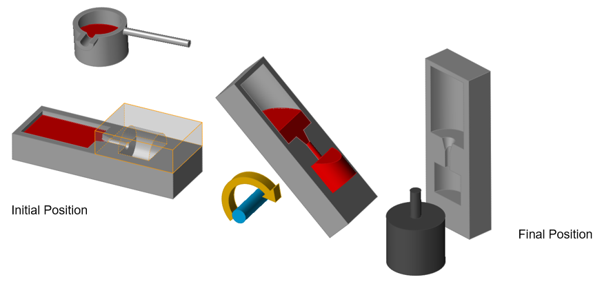

- Tilt Pouring
- Rotation axis
- Select X, Y, or Z to define the axis of rotation. The tilting rotation follows the same order as the XYZ coordinate axis; if you select Y as the axis of rotation, then Z will rotate over X; if you select Z, then X will rotate over Y, and so on.
- Move
- Move the center of rotation. Right-click to return to the Tilt Pouring parameters.
- Rotation table
- Enter values in the time vs angle table. To set a positive or
negative angle, check the sense of rotation from the final
position to the original position following the right-hand rule
to determine the sign.
- Preview
- Click Preview to check that the sense of rotation selected is the correct one.
- Investment Casting
- Shell thickness
- As the mold in investment casting is only a thin shell, Inspire Cast will use a virtual mesh for it instead. Enter the shell thickness of the investment mold to simulate its effect on the part.
- Initial mold temperature
- Enter the shell temperature at the moment of filling the mold.
- Mold material
- Use the dropdown menu to choose the type of shell mold material, and use the materials database to select a specific material.
