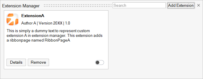

As defined in the previous code example, if the HyperMesh profile in Hyperworks loads a certain extension, the Extension Manager executes, for example, HMInit.py. Also if the profile is switched to HyperGraph, the Extension Manager does not unload the given extension.
Location of Extensions
By default, the extensions are automatically detected when saved to <username>/Documents/Altair/extensions/, but you can also add other search paths.
