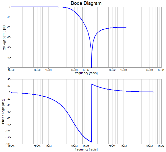

Create the Bode diagram of a 2nd order Chebyshev II low pass analog filter with a 100 radians/sec cutoff frequency and -20 db attenuation.
[b,a] = cheby2(2,20,100,'s');
tfo = tf(b,a);
bode(tfo);
Figure 1. bode figure 1
