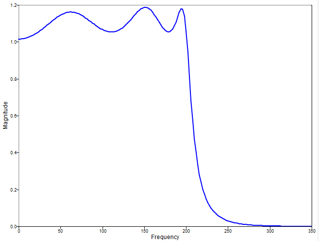

Plot the magnitude response of the preceding SoS filter, assuming a sampling frequency of 1000 Hz.
fs = 1000;
f = [0:2:350];
h1 = freqz(sos(1,1:3), sos(1,4:6), f, fs);
h2 = freqz(sos(2,1:3), sos(2,4:6), f, fs);
h3 = freqz(sos(3,1:3), sos(3,4:6), f, fs);
plot(f, abs(h1.*h2.*h3));
xlabel('Frequency');
ylabel('Magnitude');
Figure 1. sosfilt figure 1
