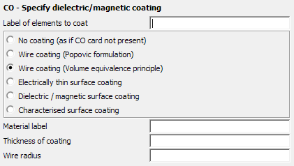

Figure 1. The CO - Specify dielectric/magnetic coating dialog, set to Wire coating (Volume equivalence principle).

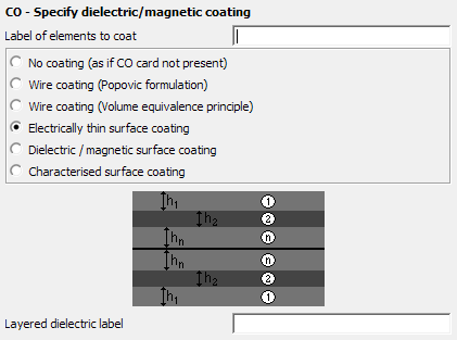

Figure 2. The CO - Specify dielectric/magnetic coating dialog, set to Electrically thin surface coating.

- Wire coating (Popovic formulation)
- In this case, the radius of the metallic core is changed internally to model the change in the capacitive loading of the wire and a corresponding inductive loading is added. The only restriction of this method is that the loss tangents of the wire coating and of the surrounding medium must be identical (for instance both media could be lossless).
- Wire coating (volume equivalence principle)
- This setting retains the radius of the metallic wire. The effect of the dielectric layer is accounted for by a volume polarisation current. The only restriction of this method is that the layer should not be magnetic in nature. This means that the relative permeability as well as the magnetic loss tangent of the coating must be the same as those of the surrounding medium).
- Electrically thin surface coating
- This option adds multilayer dielectric/magnetic coatings to the surface triangles with the specified label. Different values for the permittivity and permeability of the layers are allowed, but the total coating must be electrically (that is relative to the wavelength in the coating) thin as well as geometrically thin (see the next item).
