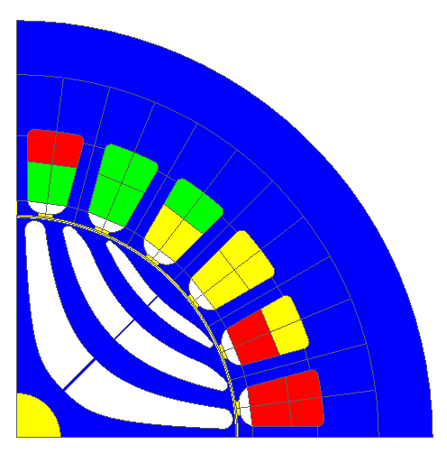

Let's consider the modeling of the following electrical machine represented by only one quarter of the full device.
Figure 1. Four poles electrical machine with three current phasis

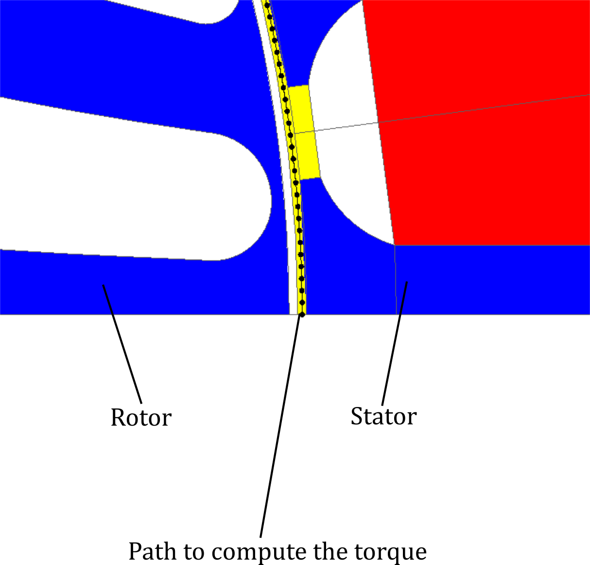

To run the shape optimization, the selected response is the Torque, a path to compute the torque is depicted in the following figure:
Figure 2. Description of the path to compute the torque with Maxwell's tensor approach

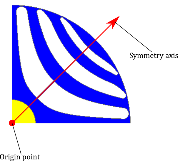

- A one axis symmetry constraint
 - A constraint on the volume of the rotor in order to decrease its weight
Figure 3. Origin point and symmetry axis for the one axis symmetry constraint
The origin axis is setted to (0,0) and the symmetry axis is setted to (0.5,0.5).
For the constraint on the volume, we want to reduce the volume of iron in the rotor about 20%, in the upper bound the value corresponding to 80% of the total volume is filled, in the lower bound 60% of the volume is filled.

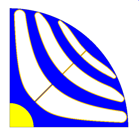

In the end, the lines where the nodes can move are selected as depicted in the figure bellow (the lines are surrounded in yellow):
Figure 4. Lines to be considered during the optimization process

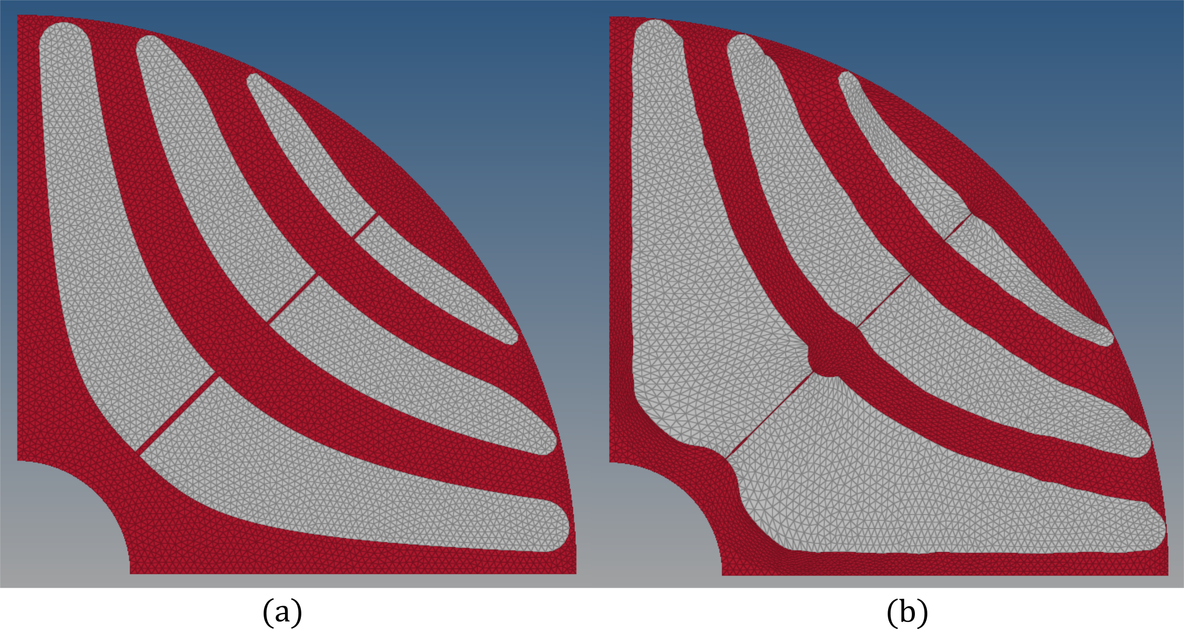

Figure 5. Initial design of the reluctance synchronous machine (a) and final design of the reluctance synchronous machine (b)
| Initial design | Final design | Difference | |
| Mean torque (N.m) | 11.9 | 12.5 | + 4.8% |
| Rotor weight (kg) | 0.5 | 0.4 | - 20% |
