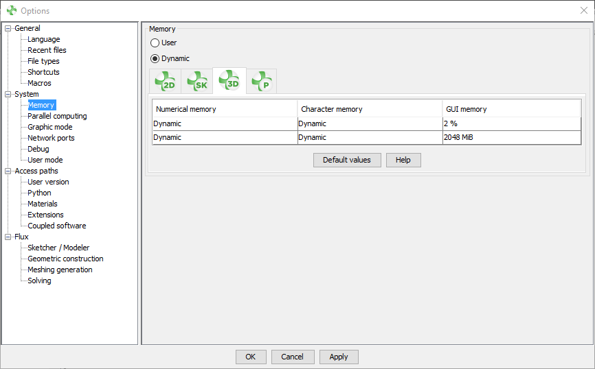

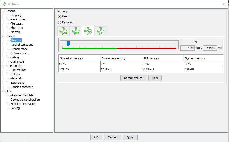

Supervisor options
User mode:
Dynamic mode:
