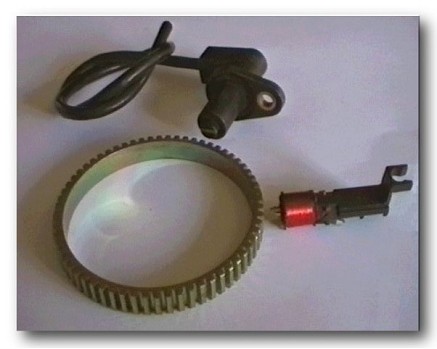

The variable reluctance speed sensor consists of a cogged wheel, a magnet and a coil connected to a measuring resistance.
Functionality
The rotation of the target wheel near the tip of the sensor changes the magnetic flux, creating an analog voltage signal that can be recovered in probes.

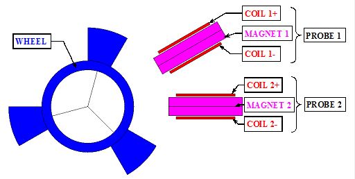

The device is described in Flux as follows:
- one cogged wheel with three teeth
 - two probes with a magnet and a coil around
