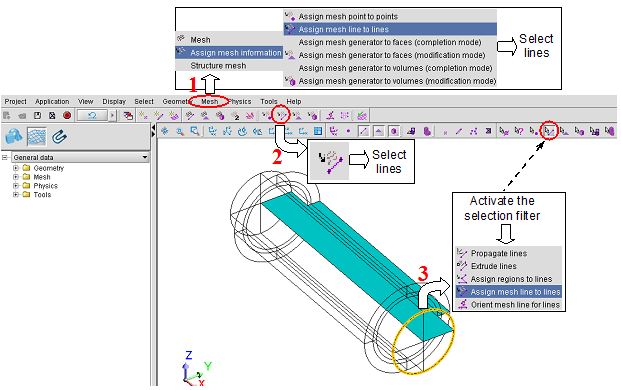

Activate the command
To activate the Assign mesh line command, which requires data selection , choose one of the methods presented in the figure below:
