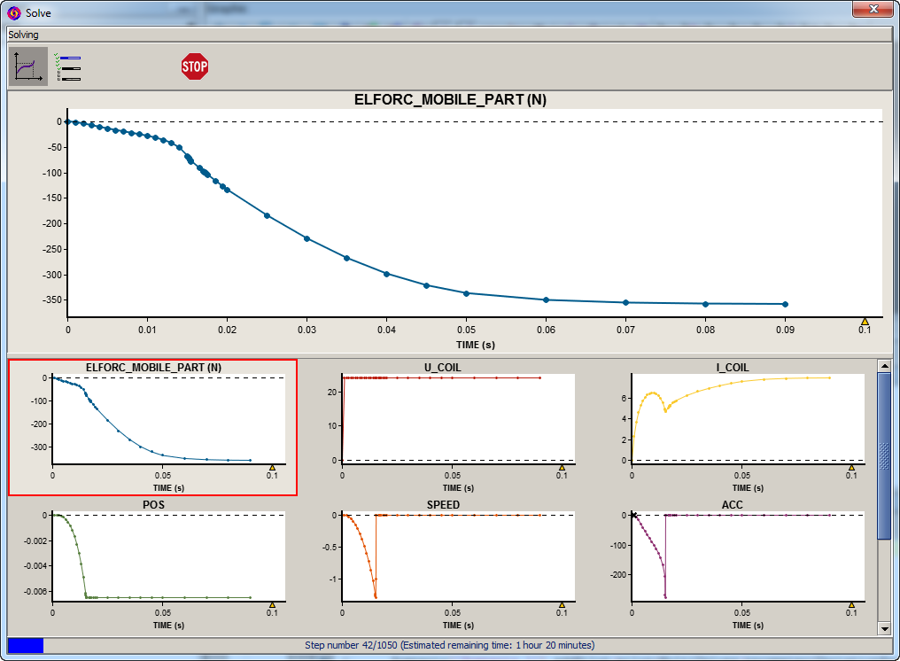

Features of Results preview context
This context is a preview of results during the solving. The displayable quantities are viewable on several viewers on which several actions are possible.(see following blocks)
Selection of the main viewer
The user has the possibility to display in large in the main viewer one of the quantities represented in one of the thumbnails by clicking on it. The selected thumbnail is marked with a red frame.

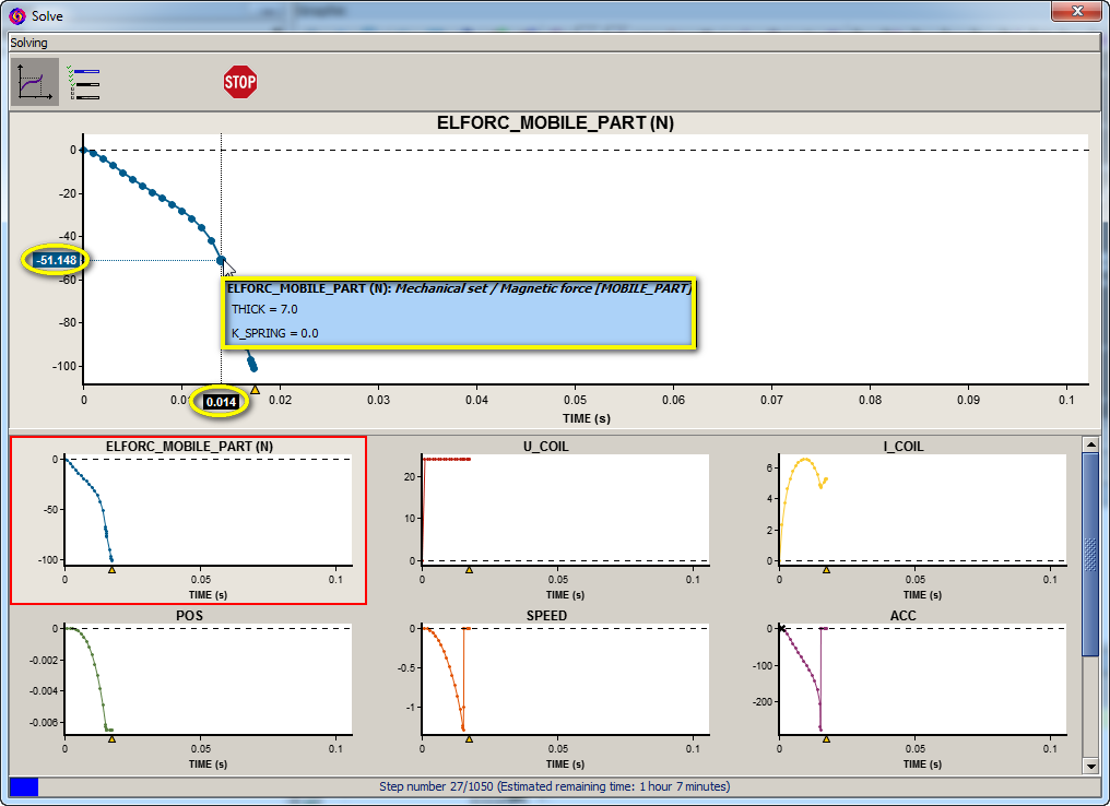

Point on the curve
- Display the X and Y values of the computed point on scales
 - Display a tooltip with the full label of the displayed quantity as well as the corresponding fixed values of the other parameters defined in the solving scenario.

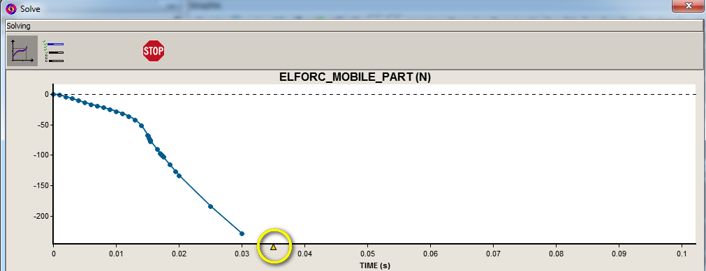

Cursor of position
A cursor is visible on the abscissa axis which allows marking the step being calculated. This position marker can be useful in the case where one or more steps have not been calculated and the curve contains breaks.

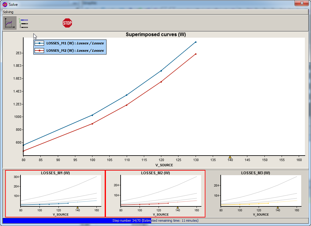

Superimposition
It is possible to superimpose curves in the main viewer. To do this click on a first curve then use the Ctrl + mouse click to add or remove curves

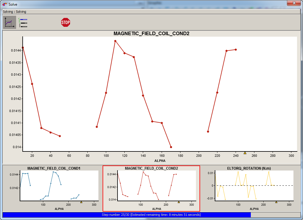

Management of step not computed
It is possible to have a non-computed step for several reasons, a non-convergence or a geometric collision for example.
In this case the solving iterate to the next step and there will be an interruption of the displayed curves.
