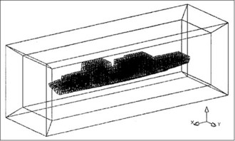

The second example consists in the numerical modeling of a ship (“La Fayette” frigate of the French Marine represented in the figure below).
The ship structure is only made up of bars, which are represented and modeled via the lines (line regions). For this type of structure that is relatively complex, the use of the algorithm of faces and volumes construction is expensive, it often takes a long time and it generates many useless faces and volumes .
To avoid this difficulty, we should place the lines within an air volume without building the group of faces and volumes that will not be used.

To avoid the building of faces and volumes of the ship, the user should modify the nature of the points and lines of the ship (“in air”) and then start the construction of faces and volumes. Thus, a single group of faces (boundaries of the study domain) and one volume (air volume that includes the group of lines and faces) will be built.
The points and the lines:
- are not taken into account during the construction of faces and volumes
 - are taken into account during the mesh building and assignment of line regions
The simplified geometry in a wire-mesh shape of the “La Fayette” frigate consists of about 3 300 points and 8 556 lines on which the (“in air”) nature has been imposed. These points and lines are placed within an air volume surrounded by the infinite box (24 faces and 7 volumes).
