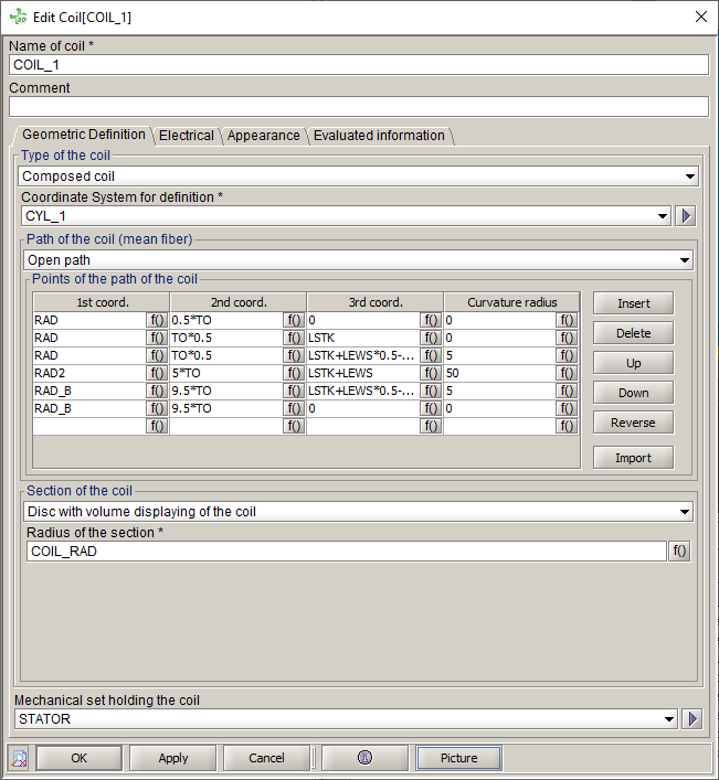

To facilitate the creation of composed coils (non meshed), several features are available in the creation dialog box :
- Insert a point in the list via the button
. - Delete a point in the list via the button
(after activating one of the cells of the
line to be deleted).The definition line of the point is fully deleted, i.e. the 3 coordinates as well as the curvature radius.
- Move a point up or down using the
buttons
and
(after activating one of the cells of the line to be
deleted). - Reverse the order of the points in the table using the button
(allows, among other things, to easily change the

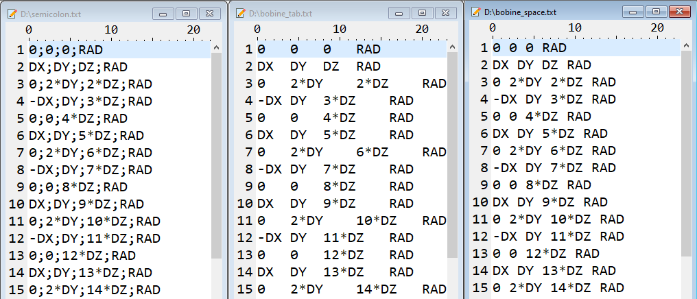

direction of the current in the coil). - Import a list of points contained in a TXT
file in order to fill the points table with the desired list of points
via the button
.If the table already contains points, the import will overwrite them all and replace them with the list of points of the imported file.
The file must contain 4 columns: the coordinates X, Y, Z and the value of the curvature radius. The separator can be:
- a semicolon
- a space
- a tabulation
