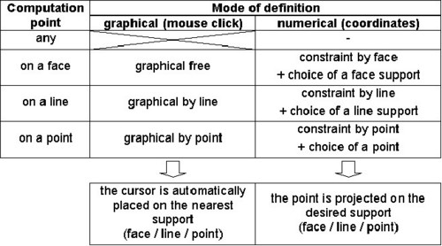

| arc defined by three points | arc of circle |
three points * (graphical or numerical capture) |
| arc defined by center, radius and angles | arc of circle |
center coordinates, radius, starting angle and ending angle |
