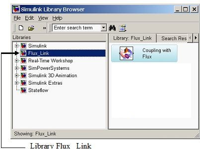

The new library of Flux – Matlab Simulink coupling is added to the list of old libraries listed for the historical Flux2D.
The next figure shows the location of the new library added in the Simulink library.
| Element | Function |
| Librairie Flux_Link | Library that contains the Flux – Matlab Simulink couplings. This library is automatically accessible with Simulink Library Browser only if the opening of the Matlab Simulink has been made through the Simulink link in the Flux supervisor. |

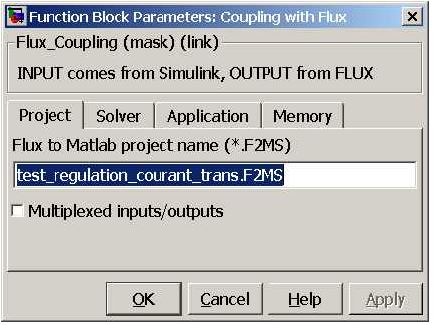

Here is the content of the «Project» tab:
| Flux to Matlab project name (*.F2MS) |
Permits the user to fill in the name of the project *.F2MS (Flux to Matlab Simulink) that is the same as the Flux project name to ensure successful coupling between the two software. Attention to correctly enter the extension .F2MS |

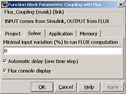

Here are the contents of the «Solver» tab:
| Minimal input variation (%) to run FLUX computation | Permits to define a percentage of variation of the input parameters between two calculation steps under which the Flux calculation will not be carried out. What matters is to be able to carry out several Simulink time steps, without systematically carrying out a Flux calculation. |
| Automatic delay (one time step) |
Permits to Flux to calculate the output parameters with a delay of one step and to transmit them to Simulink for the calculation of the following step. This automatic delay mode is indispensable in case of retro-action between output and input to avoid the algebraic loops. However, if there is no retro-action, the automatic delay should not be activated, as this would imply a delay of one step upon the output parameters. |

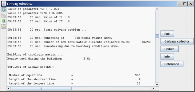

| Flux console display | Permits to display a supplementary window where Flux actions are entered. This is the equivalent of the Historical zone visible in Flux, zone placed below the geometric view. |

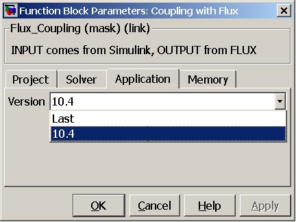

| Version |
Permits to choose the Flux version to be coupled with Simulink during the solving process. The user has a choice between:
The same for the static initialization. It is activated or not in the Flux project upon defining the application.

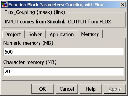

Numeric memory |
Permits to define the numeric memory allocated for
Flux Note: The value "0" allows to launch Flux in dynamic
memory
| Character memory | Permits to define the character memory allocated for
memory
