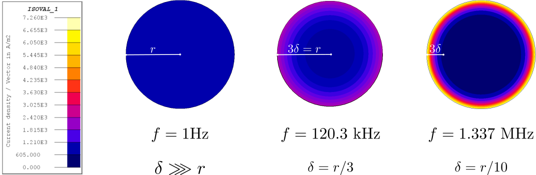

Physicists and Electrical Engineers use the term skin effect to explain current concentration phenomena linked to the parameters above. This term comes from the fact that, in the significant case of conductors subjected to a sinusoidal excitation at a frequency , a length given by
describes the depth below the conductor surface, concentrating a fixed portion of the current. This length is called the skin depth, and one may show that about 95% (or 1-e-3) of the total current flows within a depth of three times in a conductor.
The skin effect may be interpreted in terms of an induced current density component flowing in the coil. This induced component modifies the overall current density distribution and opposes to magnetic flux variations dictated by the imposed current, as predicted by Faraday’s law of induction. The example in Figure 1 depicts the skin effect at increasing frequencies in a 1 mm2 round copper conductor traversed by a sinusoidal current with an amplitude of 1 mA.
Figure 1. Skin effect affecting the current density distribution in the cross section of circular copper conductor at increasing frequencies or decreasing skin depths

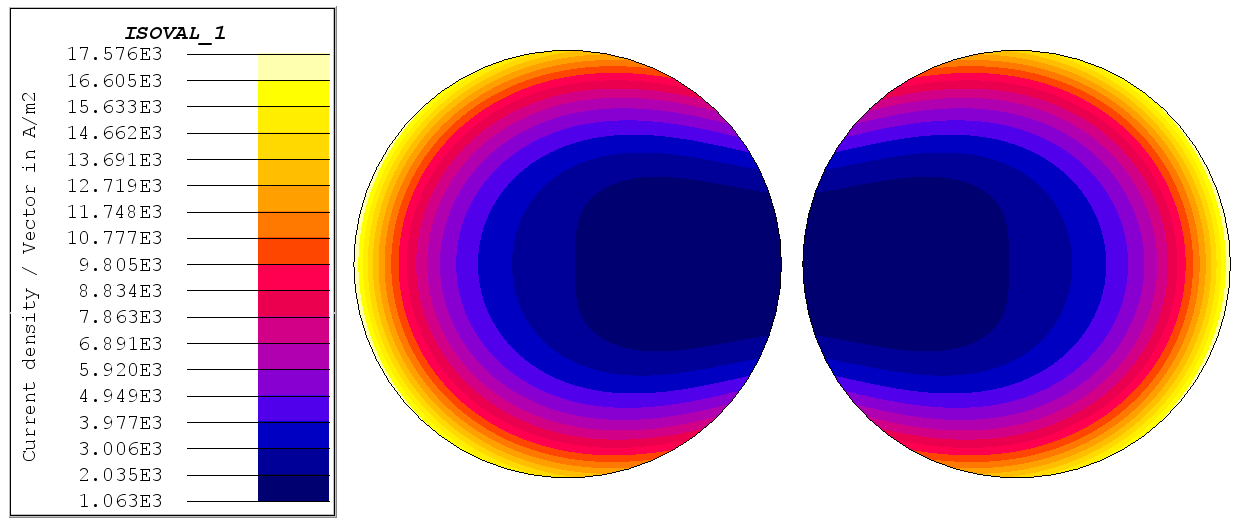

Figure 2. Proximity effect affecting the current density distribution in the cross sections of two neighboring, parallel round conductors. In this example, both conductors are traversed by a sinusoidal current flowing in the same sense.

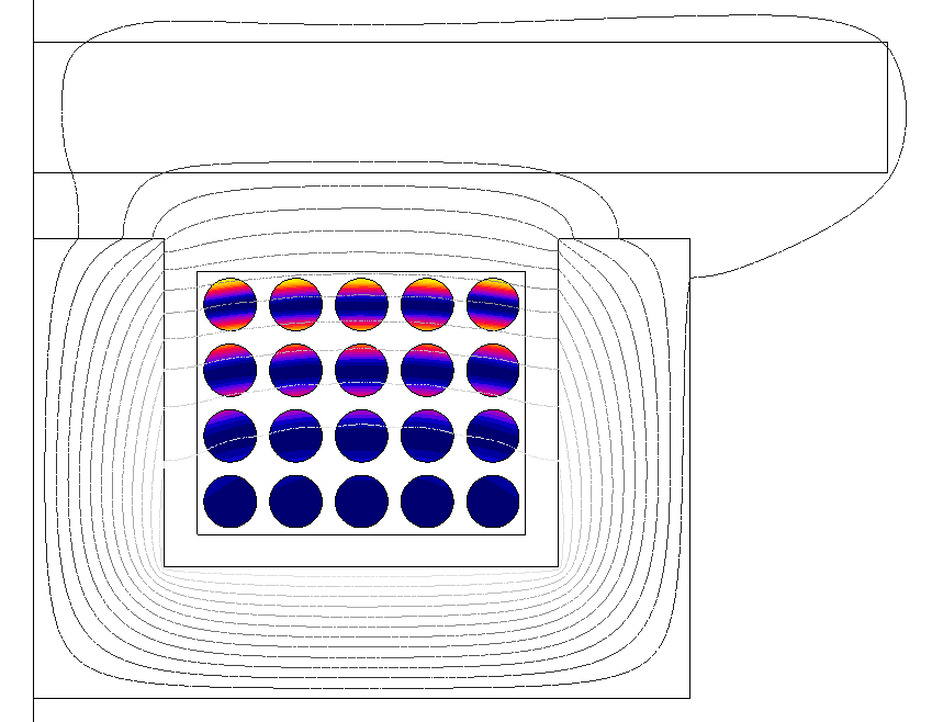

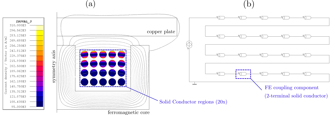

To compare the use of Solid conductor and Coil conductor regions, let us consider the modeling in Flux 2D of a hypothetical induction heating device consisting of a 20-turn coil magnetizing a linear ferromagnetic structure and a copper plate. The coil itself is formed from a copper conductor with a circular cross-section and fed by a current source at increasing frequencies.

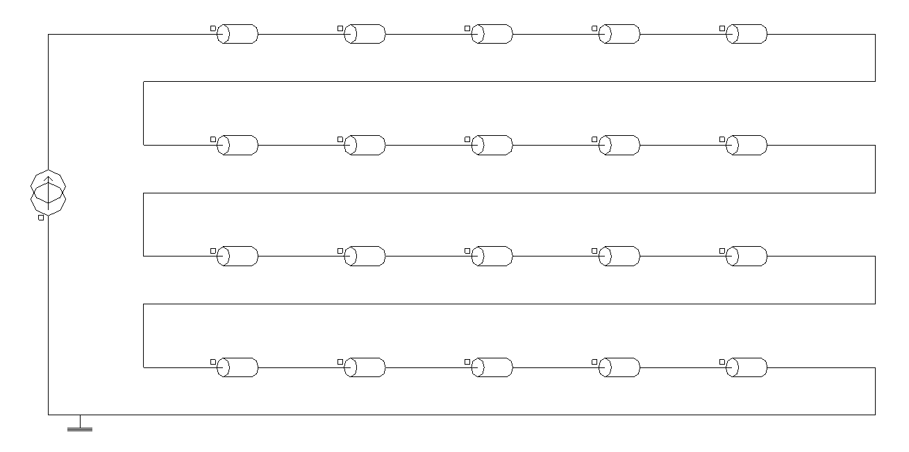

Figure 3. A Flux 2D project modeling a 20-turn coil in a hypothetical induction heating device operating at 1 kHz. Each coil turn is assigned to a Solid Conductor region, and their current density distributions affected by the combined skin and proximity effects are shown in (a). The coupled electric circuit containing one FE coupling component for each Solid Conductor region is shown in (b).

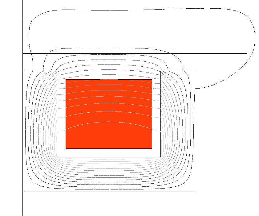

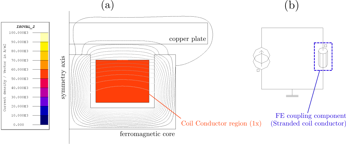

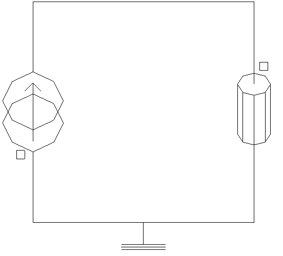

Figure 4, on the other hand, displays the same device modeled with a different approach. The twenty turns are no longer represented individually in the geometry and a single coil conductor region is assigned to a rectangular surface enclosing the winding. Consequently, only one FE coupling component (Stranded coil conductor type) is required, and both the geometry description and the representation of the external circuit become simpler.
Figure 4. The same induction heating device operating at 1 kHz, but now modeled in Flux 2D with a single Coil Conductor region. In this approach, Flux evaluates a uniform equivalent current density in the Coil Conductor region. On the other hand, the geometrical description of the model and the external circuit (b) become straightforward.

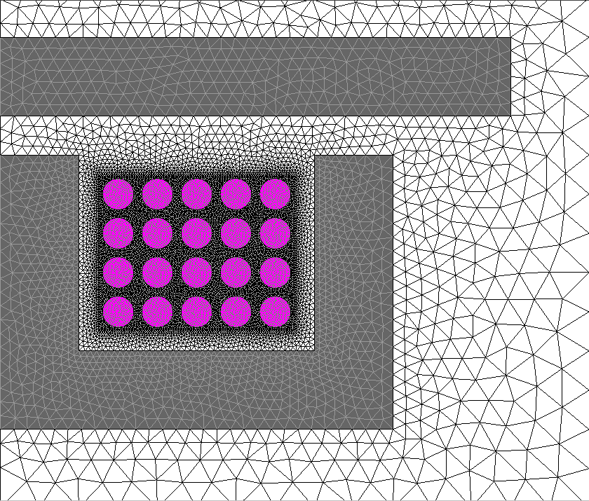

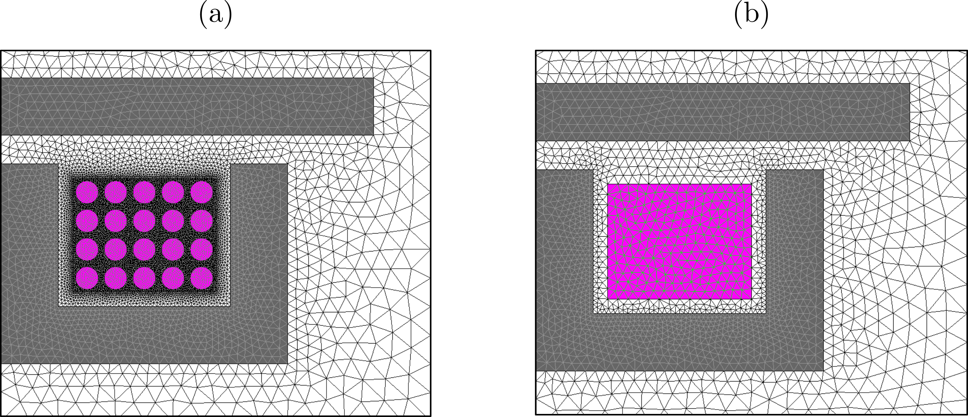

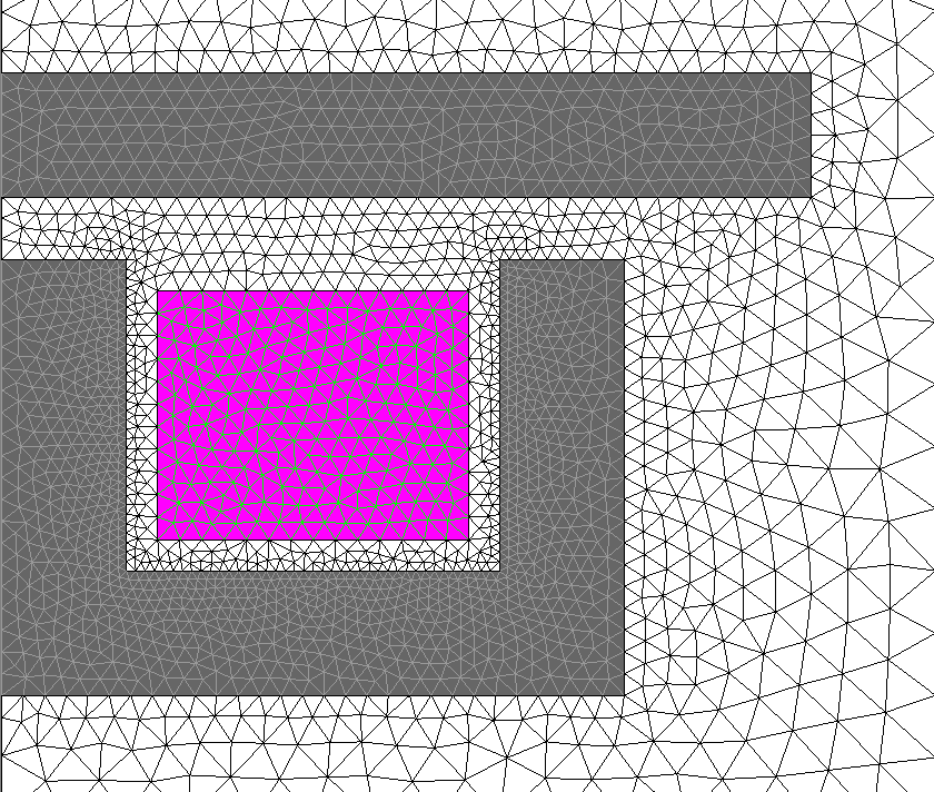

Adopting the Coil Conductor region approach also leads to simpler meshes (and consequently to smaller memory requirements and shorter computation times) as shown in Figure 5.
Figure 5. Comparison between the meshes discretizing an induction heating device in 2 different modeling approaches. In (a), the coil turns are fully described in the geometry and assigned Solid Conductor regions. In (b), a single Coil Conductor region is assigned to a rectangular face enclosing the winding.

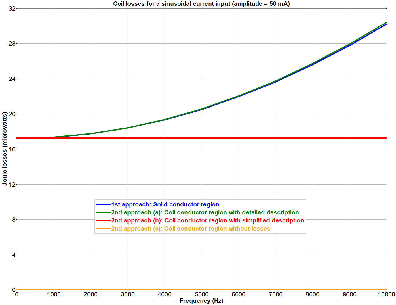

Figure 6. Comparison between the frequency behavior of the Joule losses provided by different modeling approaches in Flux .

| Coil Conductor with a simplified geomerical description | Joule losses are non-zero and constant at any frequency. Results are accurate for direct current and low-frequency excitations. |
| Coil Conductor Without Losses |
Joule losses are constant and equal to zero at any frequency. |
