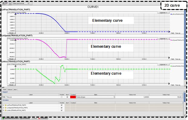

- curve or elementary curve, a curve (in the usual sense of the term), i.e. the representation of the evolution law of a phenomenon
 - 2D Curve*, the entity Flux that regroups one or more elementary curves
Example
The notions of 2D curve and of elementary curves are explained in the example below.
The 2D curve called CURVE1 regroups the following elementary curves:
- LinPos(TRANSLATION_PART)
 - LinSpeed(TRANSLATION_PART)
 - LinAcc(TRANSLATION_PART)
