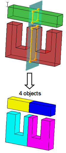

The geometric operation s allows cutting one or more objects as a reference plane in two steps:
- Detection of cut section: intersection between objects to cut and reference plane passing through these objects
- Choice sections to cut

The application of a cutting of objects has as result:
- N resulting cut objects following the number of cut sections and the number of closed contours (OBJ_CUT_1, OBJ_CUT_2, …OBJ_CUT_N).
- A geometric operation CUT_1. This geometric operation is a specific entity of the modeler that permits to ensure the cycle of life of the construction (creation - modification - deletion).
- N geometric operations corresponding to the creation of each object (CUT_1_1, CUT_1_2, …, CUT_1_N)
- The operation CUT_1 has been added in each geometric operation list linked with each object OBJ_CUT_1, OBJ_CUT_2, …OBJ_CUT_N
- Each geometric operation (CUT_1_1, CUT_1_2, …, CUT_1_N) is respectively added in the list of geometric operations linked with each corresponding object (OBJ_CUT_1, OBJ_CUT_2, …OBJ_CUT_N)
