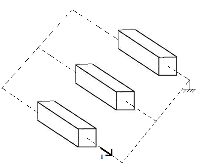

| Configuration | Choice in Flux |
                                     The conductors are connected in parallel. The eddy currents flow into all solid conductors. Example: Squirrel cage of induction machine
                                For all the solid conductor regions to connect in parallel, choose: No circuit: Conductor in parallel with all others of this same type |
