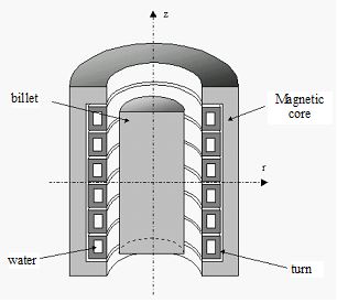

Studied device
The device to be analyzed is a cylindrical billet, heated by the Joule effect of the induced current.
The studied device, represented in the figure below, includes the following elements:
- Cylindrical billet
 - 6-turns coil
 - Magnetic core
Operating principle
The 6-turns coil in series is supplied by a source tension of 120V a.c. and a capacitor of 25 μF, is parallel connected to the coil.
