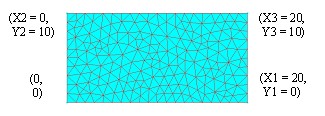

                         Build the geometry:
| 3 |
                         Mesh the device:
| 4 | Save the project under the name BASE.FLU |
Stage 1: final result
The project BASE.FLU contains:
- 6 parameters,
 - 4 points ((3 are parameterized))
 - 4 lines (segments)
 - 1 meshed face

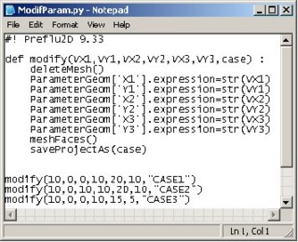

The command file ModifParam.py containing the saved sequence is presented as follows:
Stage 3
To modify the previous command file using the PyFlux syntax:
| Step | Action |
| 1 | Write a function in the PyFlux language, which enables the automatic creation of a Flux project (corresponding to a set of parameters) starting from a base project BASE.FLU. |
| 2 | Write the calls of the previous function to create the 3 desired cases |
| 3 | Save the command file |
Stage 3: file explanation
The command file ModifyParam.py containing the modify() function and the calls of this function is presented as follows:
| Element | Function |
                     indication on the executable program |
                         definition of the modify() function having as input 7 parameters (6 numerical values to define the geometric parameters X1, Y1, X2, Y2, X3, Y3 and 1 string to define the name of the project)  |
                     deletion of the mesh |
                         modification of geometric parameter (X1 takes the value VX1 , converted into string by the method s tr() , …)  |
                     meshing faces |
                     saving the project under the name defined by the input parameter case |
                         call of the function to build the first case, …  |
