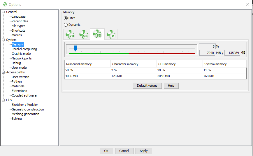

- User (default mode) : static memory management
If User is checked, then standard values for the numerical and character memories are assigned by default by Flux according to a certain number of criteria (module, computer characteristics, etc.)
These default values evolve as versions and technological advances on the machines evolve.
The user can of course modify them if required using the memory space table.

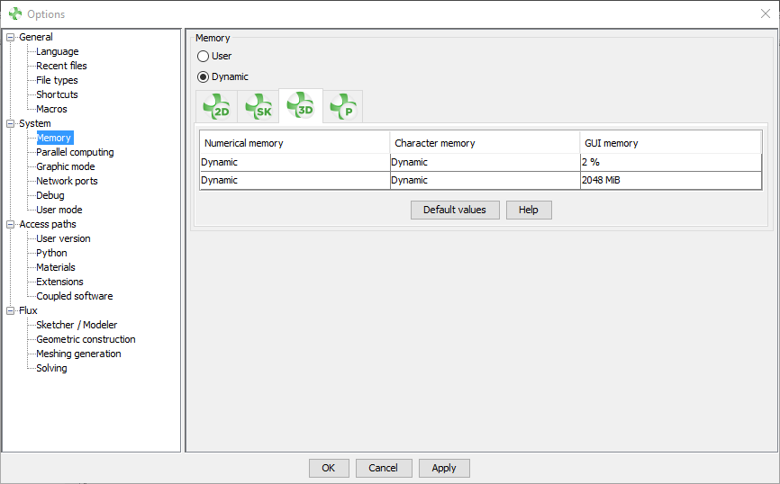

 - Dynamic : dynamic memory management
If Dynamic is checked, then the numerical and character memories are dynamically managed by Flux during its execution.
So in this mode, the user does not configure the numerical and character memories.

GUI memory
For the moment, whatever the memory management mode chosen (User or Dynamic), the GUI memory is managed only statically, a default value is set according to the modules Flux 2D, Flux Skew, Flux 3D or Flux PEEC.
The user has of course the possibility to modify it if required using the memory space table.
System memory
System memory only appears if the user has chosen the User memory management mode.
