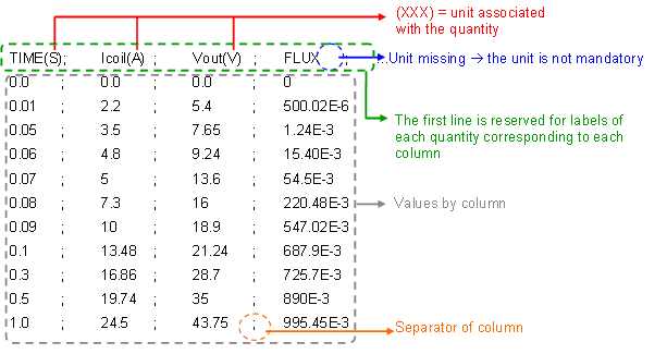

Formatted txt file
Here is the format to use in the file so that the importing of a curve starting from a formatted file should be possible:
There will be N-1 imported curves for a file containing N columns (the first column being reserved to the parameter in abscissa).
