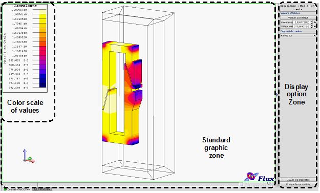

The computed isovalues/isolines are displayed on the chosen support and vizualized in the graphic standard zone with the following item added:
- a color scale
 - a display option zone ( isovalues/isolines: option )
| Zone | Function |
| Scales of values |
                         Zone comprising the scales of values calculated and displayed with the correspondence of the color shade . These scales can be displaced in the standard zone, enlarged or reduced.  |
| Standard graphic zone | Zone comprising the geometric view of the device with the displaying of the calculated isovalues and isolines. |
| Display options zone |
                         Zone comprising the display options of the calculations of isovalues, isolines and arrows. Each type of calculation has an activable tab to permit to switch from the display options of the isovalues to the display options of the arrows.  |
