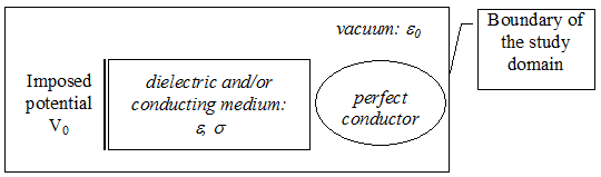

Typical example
A typical example of problem treated as a Transient Electric application is presented in the figure below.
 : Regions representing the main parts of the studied device
            (volume regions in 3D and surface regions in 2D problems)
 : Regions representing the sources (face regions in 3D and
            line regions in 2D)
