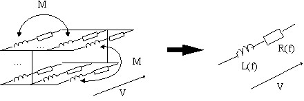

In the case of a 1D mesh, the conductor is split into elementary conductors of smaller cross-section (see figure below).
(An elementary conductor is a 1D element of mesh where the current has a privileged direction of flow: principal direction of the tube).
An elementary conductor is modeled by using a partial electric circuit (see figure below), in which the current density is uniform.
With the previously described analytical formulas, it is possible to calculate: the partial resistance (Ri) and the partial inductance (Li) for each elementary conductor.

Equivalent electric scheme
The equivalent electric scheme of a tubular solid conductor is obtained by associating (in parallel) the partial electric circuits of the elementary conductors.
The values of parameters of the equivalent electric scheme depend on the frequency, because the skin and proximity effects affect the mutual couplings between the elementary conductors.
