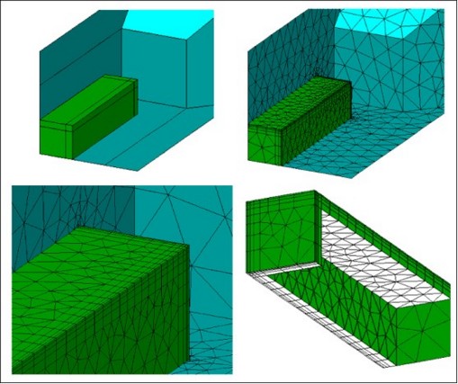

3D Example
A 3D example of mesh on the skin depth is shown in the figure below.
The most critical volumes (the volumes corresponding to the skin depth of the bar) are meshed using the extrusive mesh generator. The rest of the study domain is meshed using the automatic mesh generator (inside the bar and the surrounding air).
