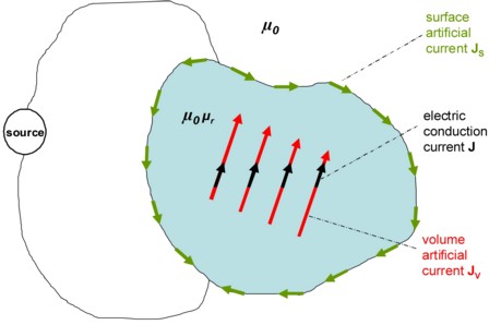

Artificial surface current density
         The artificial surface currents of density
 enable the closing of the artificial
            volume currents of density
Indeed, as the
 currents do not participate in the macroscopic electric
            conduction and as they cannot close by the external circuit, it is necessary to
            introduce surface currents to guarantee that there is no electric charge accumulation at
            the surface of the conductor.
This principle is illustrated in the figure below.
