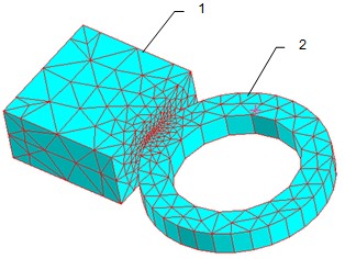

The mesh shadowed is an entity which, once assigned to two close faces facing each other, defines the progress of the repartition of the nodes on these faces by taking into account the neighboring constraints of geometry and mesh.
Progression of the assignment of the nodes on the two volumes by taking into account the mesh of faces opposite to each other.
