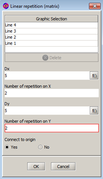

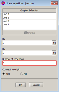

Dialog box
After the activation of this mode, a dialog box containing all the necessary fields and options to apply a linear repetition will appear.
| Linear repetition (vector) | Linear repetition (matrix) | |
| Illustration |
| Graphic selection | Permits to get information on the list of entities to be repeated by selecting them graphically* | |
| Dx | Delta on the abscissas between the entities of origin and the repeated entities | |
| Dy | Delta on the ordinates between the entities of origin and the repeated entities | |
| Number of repetitions | The number of repetitions along the vector described by Dx and Dy (set by default at 1) |
                         The number of repetitions on X with a delta Dx (set by default at 1) + The number of repetitions on Y with a delta Dy (set by default at 1)  |
| Connect to origin |
                         Option common to all the modes of construction symmetry and repetitions  |
*It is possible to unselect the entities graphically or by using the button Delete.

Apply a linear repetition (vector)
The process to apply a Linear repetition (vector) is presented in the table below.
| Stage | Description |
| 1 | Activation of the mode |
| → | A dialog box is opened |
| 2 | Graphic selection of entities to be repeated |
                         The field « Graphic selection » is filled in The selected entities are highlighted  |
| 3 | Choice of a value Dx (to enter) |
| 4 | Choice of a value Dy (to enter) |
| 5 | Choice of a number of repetitions (to enter) |
                         The fields « Dx », « Dy » and « Number of repetitions » are filled The outline of the resulting entities of the repetition will appear  |
| 6 | Choice of the option « Connect to origin » : yes or no |
| 7 | Validation of the repetition by OK |
                         The dialog box closes. A VECTOR transformation is created. The resulting entities of the application of the repetitions are created The mode of construction is automatically deactivated  |
Apply a linear repetition (matrix)
The process to apply a Linear repetition (matrix) is presented in the table below.
                         The field « Graphic selection » is filled in The selected entities are highlighted in green  |
| 4 | Choice of number of repetitions on X (to enter) |
                         The fields « Dx » and « Number of repetitions on X » are filled in The outline of the resulting entities of the repetition on X will appear  |
| 5 | Choice of the value Dy |
| 6 | Choice of the number of repetitions on Y (to enter) |
                         The fields « Dy » and « Number of repetitions Y » are filled in The outline of the resulting entities of the repetitions on Y will appear  |
| 7 | Choice of the option « Connect to origin » : yes or no |
| 8 | Validation of the repetition by OK |
                         The dialog box closes Two transformations LINEAR_X et LINEAR_Y are created The resulting entities of the application of the repetitions are created The mode of construction is automatically deactivated  |
