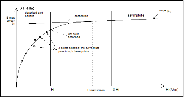

Smoothed spline mode
In the smoothed mode, the definition of the curve B(H) is simplified. This mode of definition requires fewer points than the standard spline mode.
The curve B(H) is divided into three parts:
- the first part is a homographic function passing through zero and describing the bend of the B(H) dependence. It is defined by a pair of values (B,H) provided by the user and it ends at the last pair of values provided by the user
 - the second part is a homographic function for tangent connection to the first part and to the last part of the curve B(H)
 - the third part is a straight line of slope μ0, which intercepts the vertical axis (H = 0) at an ordinate corresponding to the saturation magnetic polarization Js
- the pair of values (B,H) must respect an increasing order
 - the user must describe the first part of the B(H) curve, up to the bend, with:
- 5 to 8 representative points
 - 3 points imposed on this curve
 - the user must enter the value of the saturation magnetic polarization Js in order to define the asymptotic part of the B(H) curve
