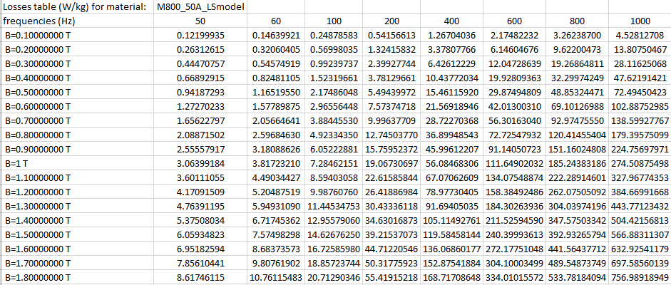

Exporting the iron losses map of the steel sheet
The iron loss map of a steel sheet is a table of iron loss density values (W/kg) given as a function of the frequency (Hz) and of the peak magnetic flux density (T).
To create this map, MILS uses the identified LS model to reconstruct hysteresis loops admitting sinusoidal time variations of the magnetic flux density. The frequency and the peak magnetic flux density ranges are fixed and cover values relevant to the design of electromechanical devices (from 0.1 T to 1.8 T and from 50 Hz to 1000 Hz, respectively).
To export the iron losses map of a steel sheet after performing a full LS identification:
- Click on button Generate loss map, which is labeled as 4.4 in Figure 1.
 - In the dialog box, choose a name and a path to save the Excel file containing the iron loss map.
            Figure 2. Example of an iron loss map in Excel format exported by MILS.Additional actions available in the Model generation panel
