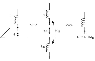

Partial inductance of a conductor ⊥ to a ground plane
The equivalent partial self-inductance of a conductor perpendicular to a ground plane has the expression:
where:
- L1 is the self-inductance of a conductor
 - M1i is the mutual inductance between the real conductor and its image

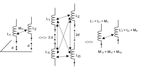

Partial inductance between two // conductors, both ⊥ to a ground plane
The mutual equivalent partial inductance between two parallel conductors, both perpendicular to a ground plane has the expression:
where:
- M12 is the mutual inductance between the two conductors
 - M12i is the mutual inductance between one of the two conductors and the image of the other one
