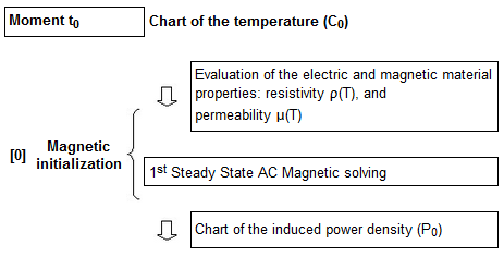

The magneto thermal coupling proposed in Flux is a coupling between the following two applications:
- the Steady State AC Magnetic application (1) which allows the computation of the active power dissipated by Joule effect in the heated components of the studied device;
 - the Transient Thermal application (2) which allows the study of the temperature evolution in the heated components of the device.
The power dissipated by Joule effect of induced currents, computed with application 1, is introduced as source of the thermal problem in application 2.
The temperature computed with application 2 is considered in application 1 for the evaluation of the material characteristics.

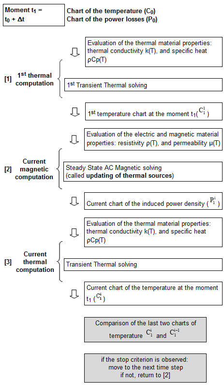

Indeed, at each time step, a local linking* of Thermal and Steady State AC Magnetic computations is achieved, until the convergence of the thermal problem is achieved, i.e. until the steadiness of the temperature field corresponding to the analyzed time step is achieved.
* The detail of the linking is shown in the following section.
Principle: details
The principle of the magneto thermal coupling in Flux is detailed below.
