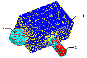

Example
In the example below, volumes (2) and (3) are very close to volume (1) but they do not touch. The zones where the volumes are almost in contact will be meshed in a denser manner.
