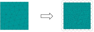

The mesh regularization process is described on the figures below:
- Initial mesh transformed into bubbles mesh
- Movement of bubbles with insertion of bubbles into holes
- Transformation of bubbles to obtain the final mesh
