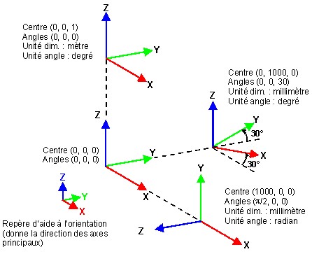

Positioning the coordinate system in its reference coordinate system
A coordinate system is positioned in its reference coordinate system using:
- the coordinates of the coordinate system center in its reference coordinate system
 - the rotation angles of the axes of this coordinate system with respect to the axes of its reference coordinate system
If unfortunately your coordinate system is not defined in this way (actions performed in a different order, or rotation axis always considered with respect to the global coordinate system) you will have to re-decompose the rotations.
Examples of positioning
Coordinate system units
The user can define the length and angle units for a coordinate system defined with respect to the global coordinate system.
A coordinate system defined with respect to the local coordinate system inherits the units of the reference coordinate system (parent coordinate system).
