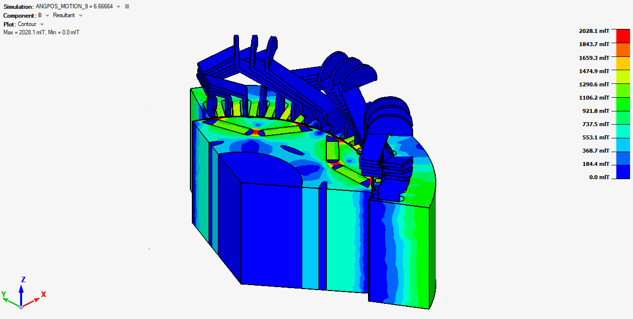

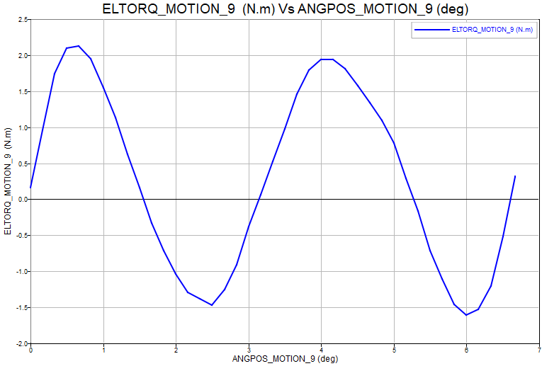

Analysis 1: Computation of the cogging torque
The cogging torque is computed with a multi-position simulation and zero current value. The multi-position is simulated with a transient application at constant speed. The simulation step is set as 0.16666 deg and up to 6.66664 deg, which corresponds to 1 mechanical degree per second...

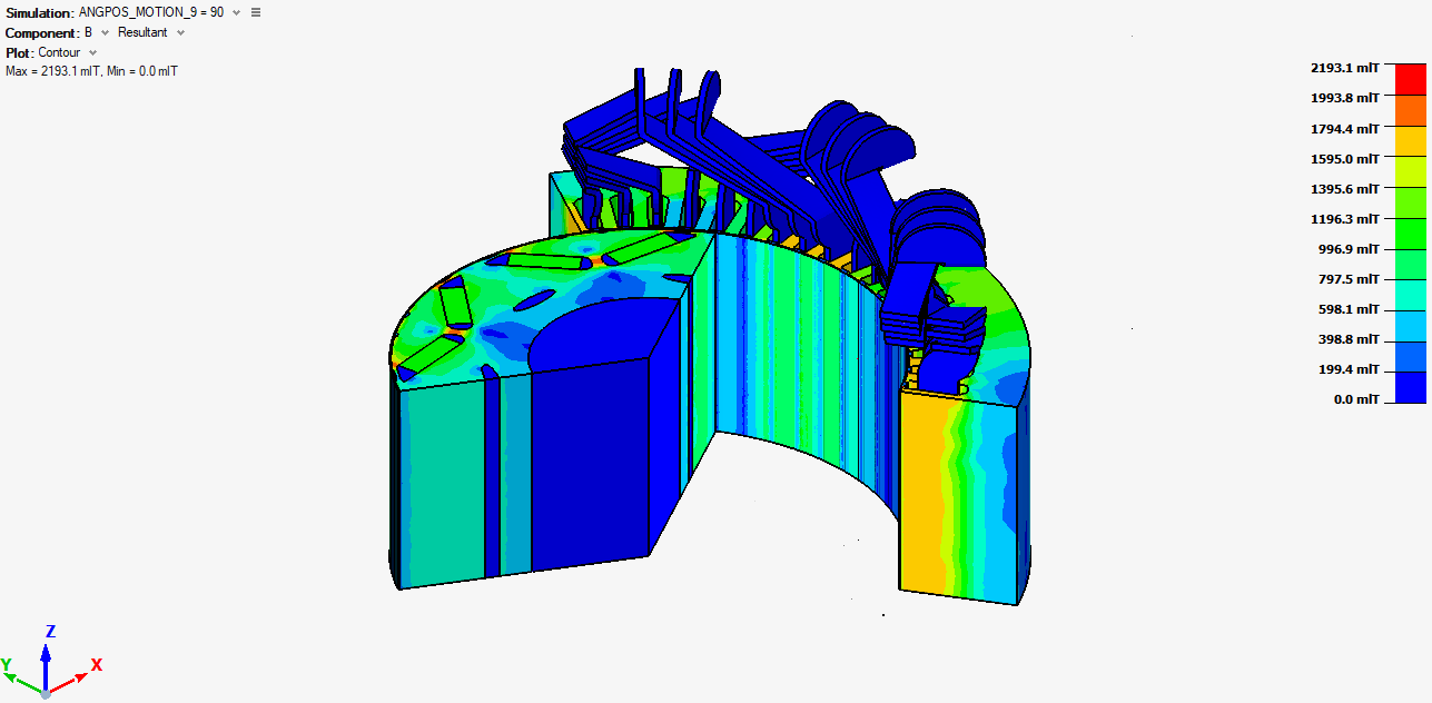

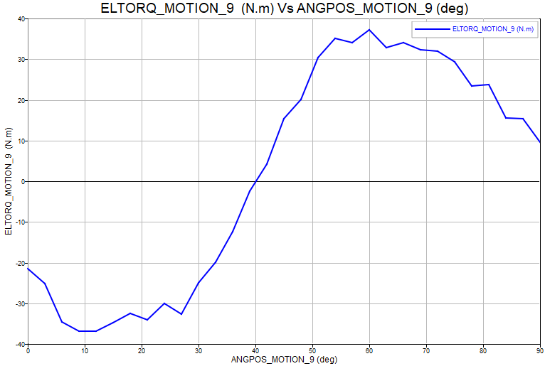

Analysis 2: Multi-static study
In this study, the rotor takes different static positions (from 0 to 90 deg). And the winding bodies (including end-winding parts) are taken into account with a defined current value. This study provides a quick performance evaluation of this motor.
