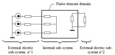

Electric sub-system: definition
The “external part” of an electric circuit, i.e. the assembly of electric components other than the components coupled with the FE* domain, is called the external electric sub-system.
The number of external electric sub-systems is equal to the number of independent electric circuits.

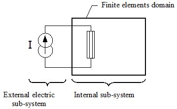

Particular case
It is important to analyze the following particular case:
- There is no circuit coupling (in the usual sense of the term)
 - There are stranded conductors supplied by current sources
The supplying of the stranded conductor is seen as an electrical sub-system.
