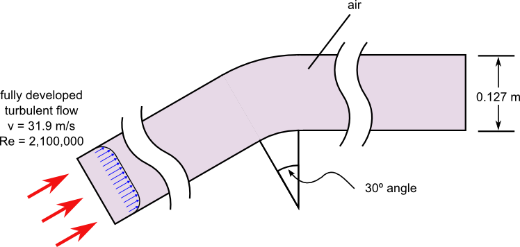

Figure 1. Critical Dimensions and Parameters for Simulating Turbulent Flow Through a Convex Channel

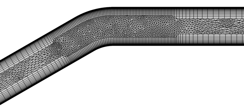

Figure 2. Detail of the Mesh used for Simulating Turbulent Flow Through a Convex Channel

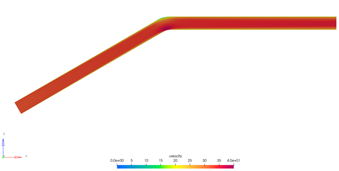

Figure 3. Velocity Contours in the Streamwise Plane

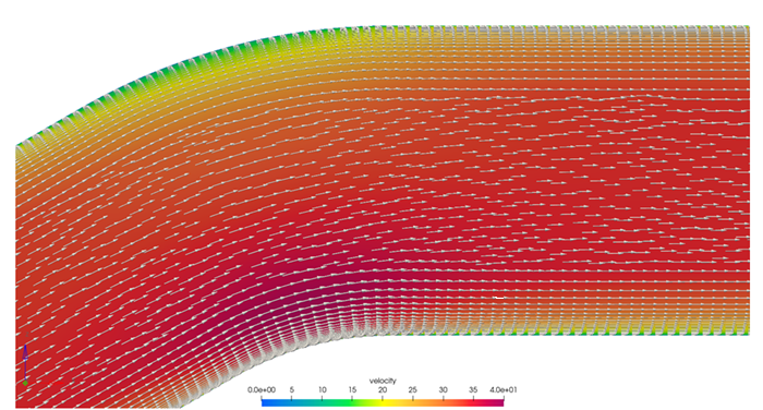

Figure 4. Close up View of Velocity Vectors and Velocity Contours at the 30° Bend

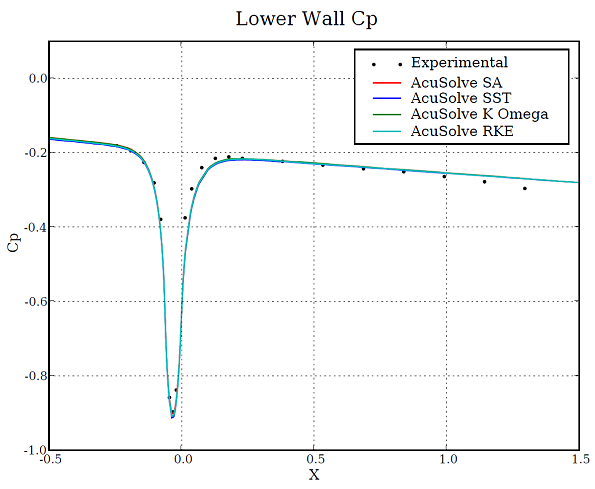

Figure 5. Coefficient of Pressure Plotted Against Relative Distance Along the Lower Wall from the Curve

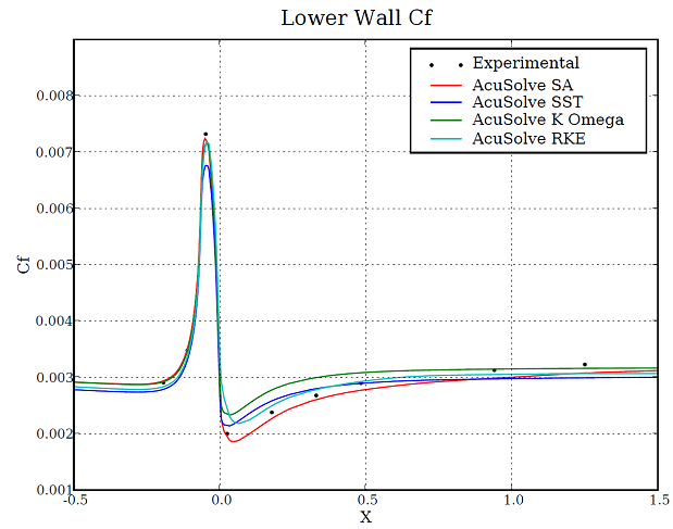

Figure 6. Skin Friction Coefficient Plotted Against Relative Distance Along the Lower Wall from the Curve

In this application, a turbulent flow through a curved channel at a Reynolds number of 2,100,000 is simulated and compared against experimental data. The AcuSolve results compare well with the experimental data for pressure coefficient and skin friction coefficient within the channel. The performance of the Spalart Allmaras turbulence model was found to be consistent with previously published results for flow through a convex-curved channel (NASA 2015) and the SST turbulence model appears to predict the shear stress on the lower wall most accurately. AcuSolve demonstrates the ability to predict the complex boundary layers resulting from the curvature of the channel and accurately predicts the propagation of the flow further downstream.
