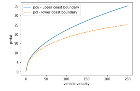

PWM Look Up table is used to calculate the PWM value using vehicle speed and accelerator pedal input. The PWM value ranges from 0 to 250. The value 50 is used for coasting, in other words at this value the motor will output 0 torque. If the PWM value is less than 50 then it means that the motor is acting as a generator and is in regenerative mode. A PWM value greater than 50 means the motor is providing positive torque for traction. The coasting region consist of two boundaries as shown in image below.
Figure 8.The region above pcu is the tractive region and the region below the lower boundary (pcl) is the regenerative region. The coasting band between these boundaries increases with vehicle speed. This is done to make the accelerator pedal less sensitive at higher vehicle speed. These PWM values can be mapped to voltage values or demand torque values. The 3D PWM characteristics are shown in image below.Figure 9.The Torque lookup table takes the PWM value, motor speed as input and generates the torque demand for motor. The regenerative torque in the Powertrain can be used to brake the vehicle in normal traffic condition. The motor provides enough negative torque to operate the vehicle with only one pedal in case of city drives. At higher vehicle velocities, the regenerative torque alone is not sufficient to stop the vehicle and hence the friction braking should be used. The regenerative torque values in this model changes with vehicle velocity as shown in image below.Figure 10.To achieve standstill condition in case of a fully released accelerator pedal, the regenerative torque is set to 0 at 0 vehicle speed. This is done by setting value of the first cell in PWM lookup table to 50 which means coasting.
