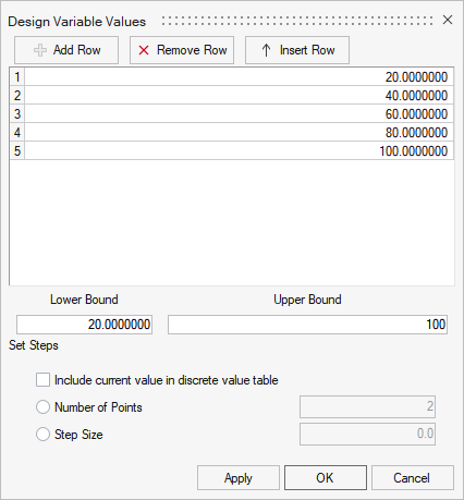

The Design Variable Values dialog opens. - For Lower Bound, enter 20.
- For Upper Bound, enter 100.
Add three more rows and define the Upper Bounds as shown in Figure 6.
Figure 6.

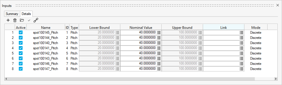

- From the Inputs dialog, open the Details tab.
Review the design variables.
Figure 8.
