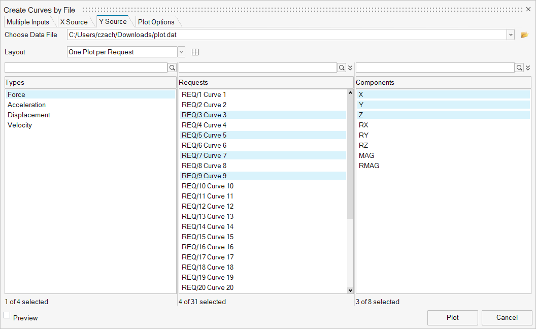

- From the Y Source tab, use the Choose Data Field file browser to open the file plot.dat.
- From the X Source tab, select Time.
From the Y Source tab, select the following:
- Type: Force
- Request: REQ/3 Curve 3, REQ/5 Curve 5, REQ/7 Curve 7, and REQ/9 Curve9
- Components: X

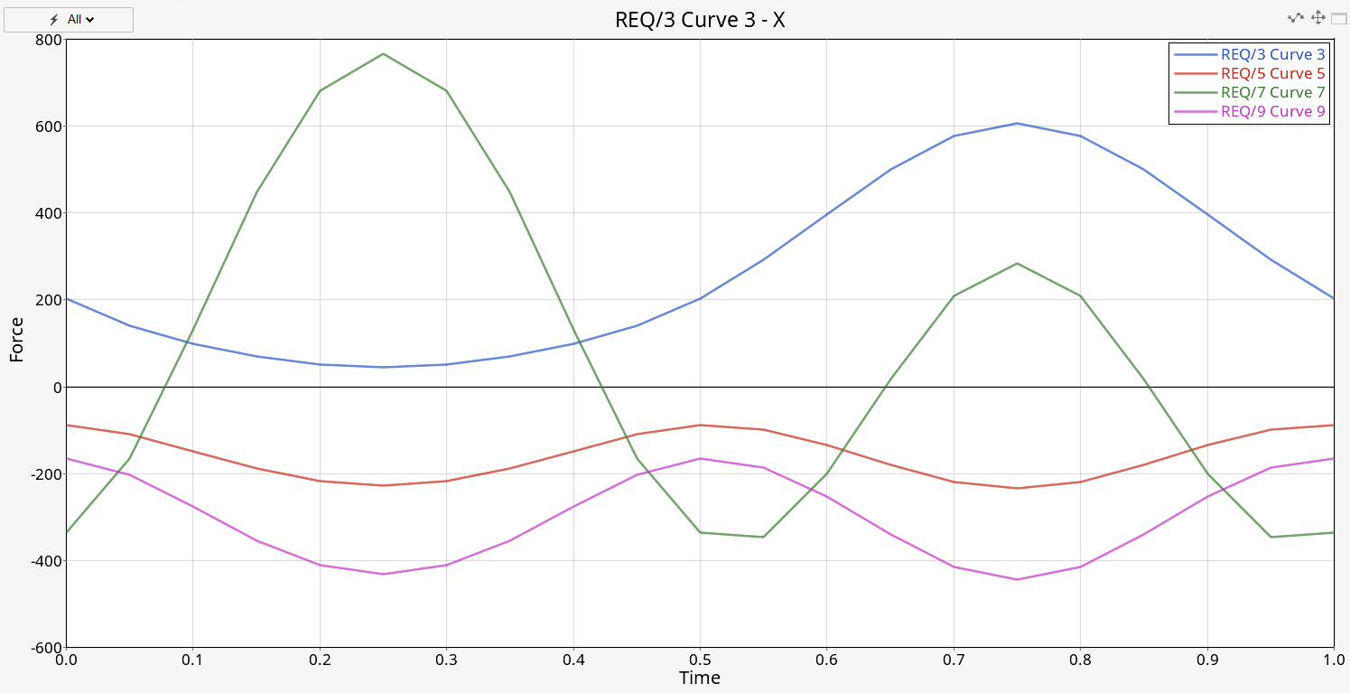

Click Plot and review the plot created.
Figure 1. - Leave the Create Curves by File dialog open.

- From the Create Curves by File dialog, go to Y Source > Components and select X, Y, and Z.
- From the Layout drop-down menu, select One Plot per Request.

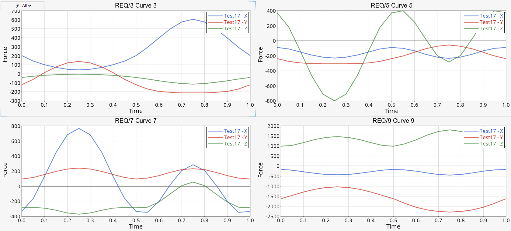

Click the Set Page Layout icon,
, and select the four window layout.
Figure 2. -
Click Plot.
Figure 3. - Leave the dialog open.

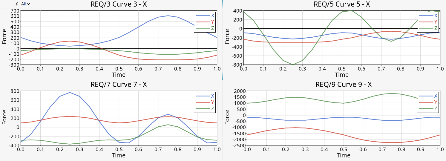

- From the Create Curves by File dialog, select the Plot Options tab.
- Under Category, click Page Options.
- Click the Font field and select Arial, Bold, 16.
Click Header to define the following:
- Label Scheme: Custom.
- Header: Deselect the Y Component.
- Font: Arial, Normal, 12.
- Alignment: Center.
- Click Footer and set the same options as you did for Header.
Click Curve Options to define the following:
- Select Show Prefix.
- Label Prefix: Test17.
- Leave Show Label selected.
- Label Scheme: Default.
Click Plot to review these curves on page 3.
Figure 4. - Leave the dialog open.
